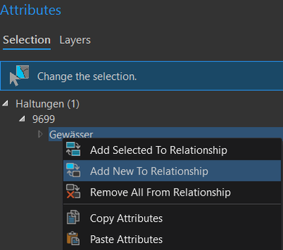

What you could do:
  1. Create a relationship class between the fc and table
  2. Select a feature

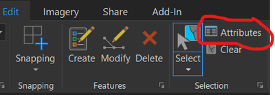

  3. Open the Attribute Pane
  4. Expand the feature to see its relationships
  5. Right click on the relationship you created, "Add New To Relationship"
  6. ArcGIS creates a new record in the related table, puts the feature's ID in the field specified by the relationship class, and opens the new row in the Attribute pane.

What you could do:
  2. Select a feature

I tried this out and it works very well.  with editor tracking applied, all the values which need to be entered automatically are done.  thanks.  very smart!
