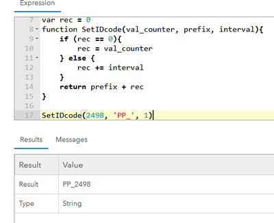

Here's the equivalent of your function in Arcade:
var rec = 0
function SetIDcode(val_counter, prefix, interval){
    if (rec == 0){
        rec = val_counter
    } else {
        rec += interval
    return prefix + rec
Here's me testing it with the sample parameters you gave:
Can you explain a bit more about how you use this, though? Is the rec variable always going to be 0, or are there other parts of the expression that alter it?

The rec variable is 0 for the first feature, so the returned valued is prefix + val_counter (PP_2498).
But then the rec varaible should get the value in val_counter for the second feature returning prefix + val_counter + interval (PP_2499) and incrementing by interval for each next feature (PP_2500, 2501,...).
Your function (mine was like yours) returns PP_2498 for every feature.
jcarlson
MVP Alum
I see. That will only work for an iterative loop, not in the Field Calculate profile. When writing a field calculation in Arcade, you have to imagine that you're already in the loop, as the expression will be evaluated for every feature.
