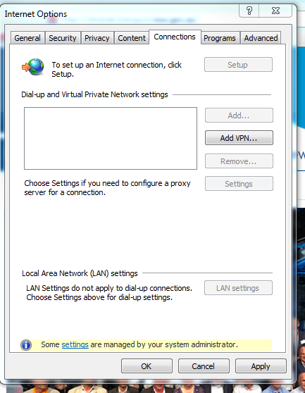

Our organisation has enforced new policy on our internet access and we are unable to see the proxy settings now as below image.
When we try to access the WFS services through arc catelog, it gives error as unable to connect. But the same wfs services are accessible through QGIS.
So, how could we configure proxy setup for arccatelog separately?
Internet explorer proxy setting

Did you check in Customize > ArcCatalog Options... > Connections (tab)? Here you can set your default user name and password for a proxy server.
Using ArcCatalog options—Help | ArcGIS Desktop
