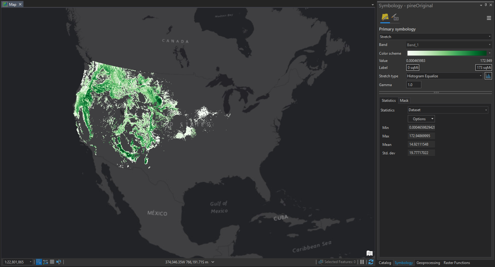

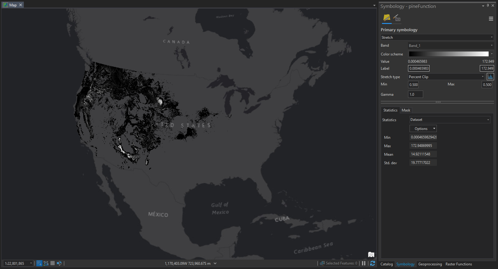

I'm having trouble with using raster function templates and using them for symbology. The problem I'm having is I set up my symbology as Stretch and save it as a raster function template for use across a large number of rasters. Problem is when I apply the function instead of Stretch it is in RGB. Here is what I'm doing,
1) Import raster.
2) Apply symbology, notice it is Stretch.

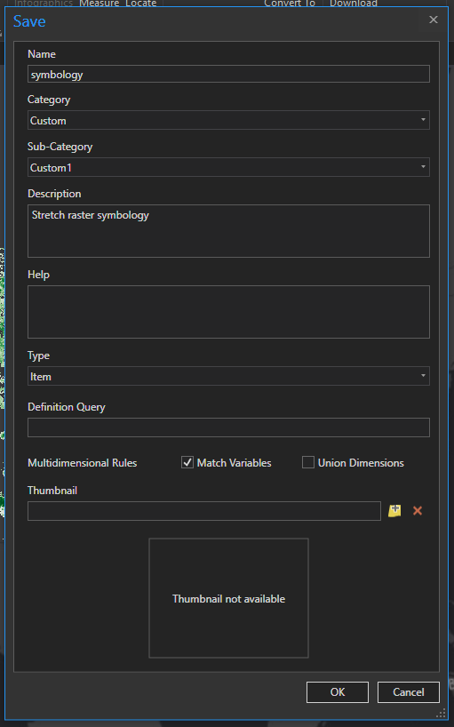

3) Export as a raster function template.
The attached video shows what happens when I apply the raster function to the original grey scale raster. Instead of Stretch it is RGB.

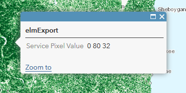

The reason this is a problem for me is because I'm trying to publish a butt-load of rasters as image services on our portal. We need to use them in analysis. The problem publishing a raster as an image service with RGB symbology is if you enable pop-ups you don't get the pixel value, you get the RGB,
