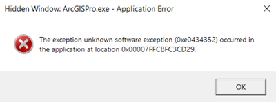

Hi there I am using ArcGIS Pro 3.0.3 and I keep getting an Application Error that is causing ArcPro to crash?
Is anyone else encountering this issue? Thanks.
