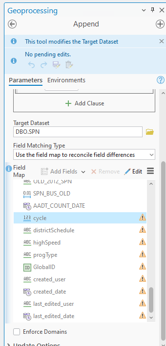

ShaunGibbins
Its odd that BUG-00015794 references pro version 3.1.1 but I have only experienced this issue with 3.4.2 and it worked fine in my previous 3.3.x versions.
In earlier version I would select on the fields with the yellow no match warning and delete them from the list but in the latest version of pro they will not delete.
