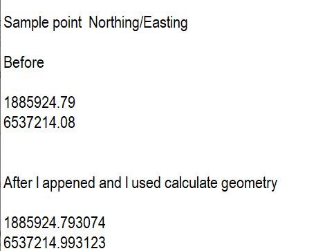

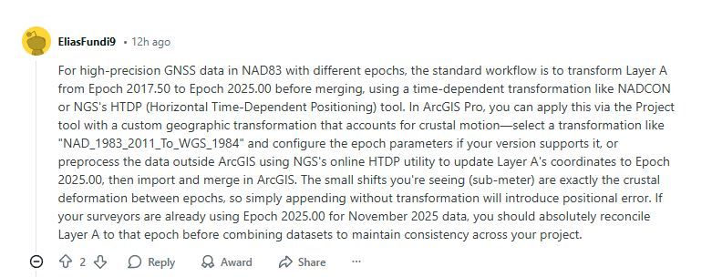

What is the standard GIS/ survey workflow to append Layer A into Layer B? My current 'Calculate Geometry' test after appending one layer to another layer resulted shifts in Northing and Easting ( decimals). What transformation settings should I use to reconcile these two different epochs? As much as I understand copying (merging, appending) them directly without transformation(HTDP , python coding, Perform a Time-Dependent Transformation,) will cause misalignment because the Earth's crust has moved between those dates. Both data are collected in 2025 (Jan 2025 and November 2025)

Try calculating using Round(coordinate, 4)  on each coordinate. Change the 4 to however many decimals are appropriate for your situation. Your Before coordinates are likely just displaying two decimal points, with actual values being longer.
Coordinates shouldn't have shifted if both epochs used the same coordinate system, but it's very difficult to get exactly the same coordinates on separate readings. If your numbers are in meters, for example, the third decimal would be 1000th of a meter. You're starting to get into accuracy levels of the GPS at that stage. It might be helpful to consider coordinates identical if the difference between them is below a threshold, rather than matching precisely.
