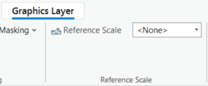

Another option to consider is to Convert Labels To Graphics for the area covering all of your map frames, then change the graphics layers' reference scales to None. While annotation requires a reference scale, graphics do not. If some of your map frames overlap you may have trouble placing the labels where you want because all map frames share the same map and therefore same set of graphics. If this is an issue, the tiled annotation may be better.
