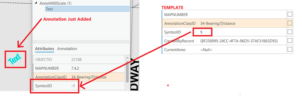

I have a lot of annotation.  As I understand it, annotation is referred to by its AnnotationClassID and SymbolID (similar to ArcMap).  My AnnotationClassID for bearing/distances have an id "34-Bearing/Distance" with a symbolid of "9" (made sure of this when converting from ArcMap).  In the following example  I have the symbolid in the template set to 9. But when I add an annotation string the symbolid is assigned a -1.   Is there a way for the symbolid that is in the template to be assigned the correct value "9" ??

Sorry --- This happens in both Arcpro 2.8 and 2.9 with a standard geodatabase.

I got that,  symbols that have a -1 are not using the symbolid. Unfortunately,  I want them to have the symbolid when I am adding.  In the annotation symbology properties I have it set to "No Substitutions" which I thought would force only reference to the symbolid.  My problem is when the template has the symbol set(in my case 9) and I do not allow substitutions,  when annotation text is added it should not assign the symbolid to be -1.   The symbol that has been added should have a symbolid of 9 as contained in the template.

There's something here that's forcing the annotation to -1. Generally that occurs when a symbol property can't be expressed as an override. For newly constructed annotation that's rare though. This likely warrants a support call to look at the scenario.
