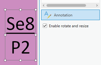

I've created a feature-linked annotation FC using the Create Feature Class wizard in Catalog:
Why is the annotation FC shown as SHAPE = Polygon in the attribute table?
I would have expected the SHAPE to be Annotation, not Polygon.

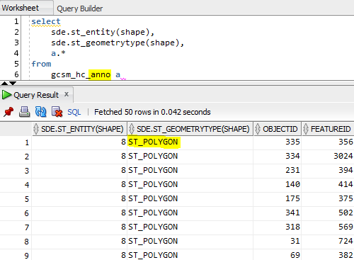

Related (SDE.ST_GEOMETRY):
select
sde.st_entity(shape),
sde.st_geometrytype(shape),
a.*
from
gcsm_hc_anno a
