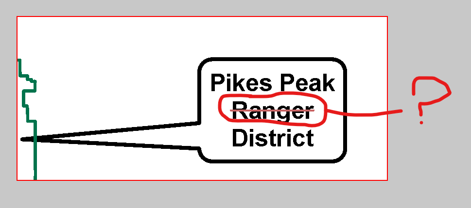

Annotation has a red line display so I did not set it as color or show line.

I created annotation myself and i have add them to each my project but looking at this and can anyone in here tell me why do I have the red line.
I did not set for the line or color for the red.  So It must be something is telling me something is wrong ?
See my screenshot here :
Yes I could have remove the annotation and add it again to my projects BUT I want to see if there is a quick way to fix it to make the line disappear ?

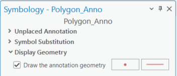

The red line is the underlying geometry for the annotation feature's text. With the annotation layer selected in the Contents pane, you can toggle the drawing of the annotation geometry from the Symbology pane.
This feature is generally intended for quality assurance workflows and not for final map presentation.

BINGO !!! Thank you for your respond. Appreciate it
