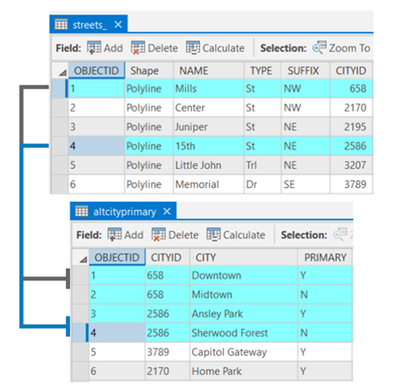

When you build a POI role locator for place names, the Place Join ID field is used to link the primary POI features to the alternate place name table using the Alternate POI Name role and the alternate POI category table using the Alternate POI Category role.
If the name of the restaurant is Denny's in the primary feature class, but it has an alternate name like "Denny's Diner", the name "Denny's Diner" would go in the alternate name table along with the associated Place Join ID value and you would need to use the  Alternate POI Name role. The same Place Join ID is used to link the primary categories in the primary feature class to the alternate name table that has the alternate category names like breakfast, lunch, eggs using the Alternate POI Category role. The data should be formatted similar to how the CityID is in the image below.
Once the primary and alternate name roles are linked together you will be able to search for the place name or alternate place name and primary or alternate category, which will return all of the place names associated with the searched category. There are illustrations of the search options at the bottom of the POI role description.
