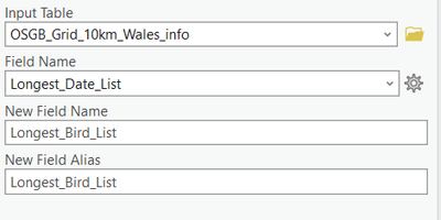

I am trying to alter the name of a 'Double' field using the Alter Field tool in Pro 3.1.3.

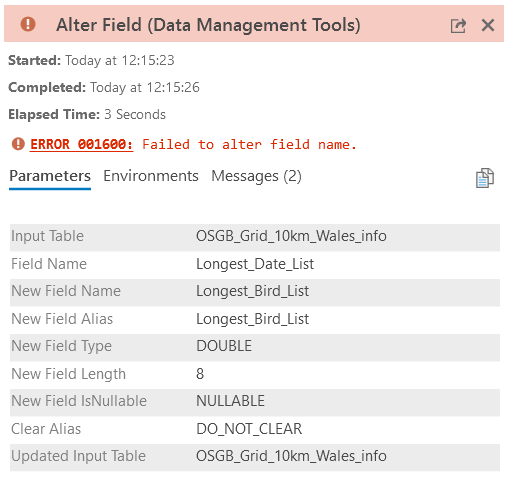

I am getting the error message 001600 Failed to alter field name:
I cannot figure out why. Here is the settings on the tool:

Interesting - so in the Alter Field GP tool help page it mentions that the New Field Type (optional parameter) "Specifies the new field type for the field. This parameter is only applicable if the input table is empty (does not contain records)."  Clearly your table does contain records.  Try this - leave the New Field Type parameter blank and run the tool again.  What is the output?
Scosh
It could be that there is an Attribute Rule that uses that field. For some reason Arc doesn't give a specific warning when this is a problem.
Zdenekprocner
A schema lock was applied to the geodatabase.  .... layer is lock. ....For your success remove the locks
