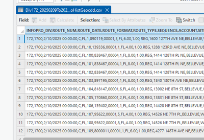

What would cause ArcGIS Pro to place all csv data into one column? In excel, the data shows up in separate columns as expected. PS: The data is blurred intentionally.
ArcGIS Pro:

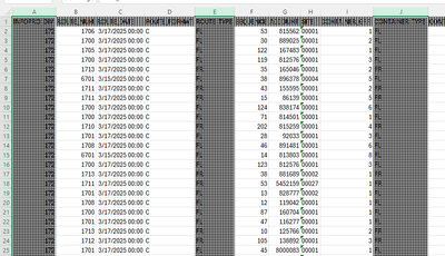

MS Excel:

Running Export Table (which is the replacement for Table to table) on the csv file didn't solve the issue but Excel to table did. Once I converted the csv to excel and ran excel to table, the columns and data were split into their correct spots. Unfortunately though, I am unable to utilise excel in this way because the CSV data that I will be working with contains more that 1 millions rows. The data is upward of 4 millions rows.
