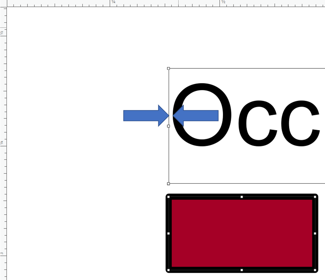

I have text that I wish to align with a red box in ArcGIS Pro 2.4.3.  In the past, the workflow was to select the two items and chose "Align Left."  However, there is a small gap between the text and the related selection box... that limits the ability to properly align the items.  In the image below, there is a small gap between the "O" and the selection box to the left.
To highlight this gap, I have indicated the gap using the two blue arrows below:
What controls this gap and can I remove it?  One more thing... all of the items are aligned to the left.

I do not think this is out of the ordinary.  It happens in ArcMap too, so I am not sure what you mean about "In the past".  The same behavior happens in any other programs I tried too.  Certain letters will do what you want, like uppercase T.  I even tried monospaced font and it still acts this way.  I am not sure the naked eye will see the difference.
