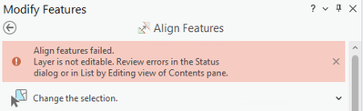

I am experiencing a problem with the 'Align Features' tool on the parcel fabric. Whenever I tried to use the tool, it gives me the error "Align features failed. Layer is not editable. Review errors in the Status dialog or in List by Editing view of Contents pane" or "No feature geometry can be aligned using this method".  I looked through the list and the layers I am trying to edit is marked as editable and the alignment method is kept the same with other layers that the tool worked on. I don not have any problems editing the parcel fabric with the other tools (Merge, Divide, Clip, etc). The 'Align Features' tool works on layers not in the parcel fabric. I can't find any reason why the error message would change between the two errors listed. What could be causing the problem?

I didn't get any answers to this, but I was able to figure out a few things.
For my problem, I didn't have ALL of the parcel fabric layers set to editable. I had a few of the layers to not editable because I didn't want those adjusted by the tool. After setting every layer in the parcel fabric as editable, I had less error messages.
This also applies to regular layers. Any feature that is within the area of being aligned needs to be editable.
For any errors after setting everything to editable, I still have no idea. Reopening the map project file makes it work sometimes.

I've found another issue with the align features tool: My parcels documents use two different spatial references in meters as well as feet and thus I have to switch my map between all these. Obviously the features in the parcel fabric are all in the spatial reference, but if my map is not set to fabric's spatial reference then align features doesn't work.
RobertChaney
Under the Quality tab, try setting the topology to No Topology when running the Align Features tool.

I'm working with a feature dataset that includes a polygon and line layer with topology rules and we are experiencing the same issue as described in this thread. We first starting noticing it somewhere around ArcGIS Pro version 3.x end of 2024 or Q1 of 2025. I am still experiencing the issue on version 3.5.2.
Even with the selected layer set to editable we still get the same message:
One thing I noticed is that if you have copies a layer in the contents pane with the same data source but symbolized differently the tool will behave as if they all need to be set to editable even if they are not visible or selected. For our case, the tool only worked if all layers in the contents pane with the same data source (both the polygon and line layers in the feature dataset) were set to editable. However, it would align both the polygon and line layers even if only the polygon layer was selected.
We've settled on a slower workflow using the reshape and split tools instead of using align features. I would love to see this tool get fixed and I'd be happy to work with Esri to share more information.
