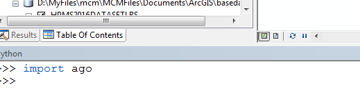

The python script aborts ass soon as it begins with an error message on not finding ago (import ago).

MaazaMekuria
I think there is a module ago and it is not in Pro 1.4.1 . check out ESRI's website if you wish.  As at first, the same code runs in 10.6 (beginning with 10.3).

if it works in 10.6 and it doesn't work in Pro, it needs to be installed for Pro, (assuming it works for both environments)... they don't share modules, Pro's environment is totally self contained and isolated from ArcMap.
You probably want the "arcgis " module if you are trying to administer AGOL from Pro
