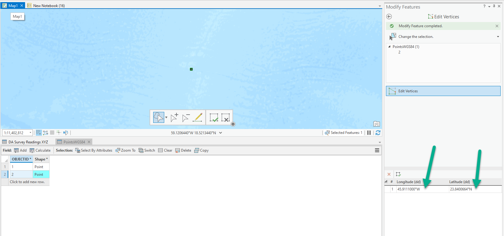

if you run the snippet above, you will get a layer, open the attribute table and try to flash/zoom the second point. you will see no point.
I tried to edit the point: just editing the vertices, but i did no modified per-se the values, just click and enter, then proceed to save the changes:
Now the point is visible.

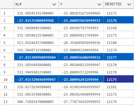

I am not able to see the the real change in the table/FC (I have a lack of knowledge), but then I made the same operation in my Enterprise Geodatabase (There I now how to really know the stored value), and check the values after I changed some of my 13 features:
As you can see the non changed values have negative values for X value, the changed ones under the sheets where modified by the addition of 360, but in ArcGIS Pro, the number appear as 27.415 W
