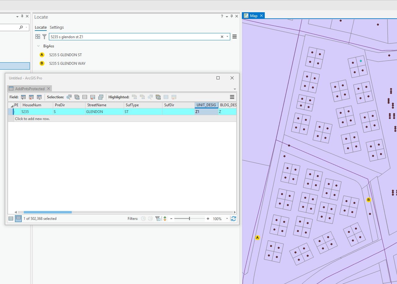

In this post, Bryan Lynn‌ describes a problem locating point addresses with units.  He experienced it in an Oracle enterprise geodatabase; today I discovered the same problem using a file geodata base.  Here are the field mapping parameters I use :

Notice in line 6 the field UNIT_DESIG is used.
If I use the unit a given address this way, it ignores it:

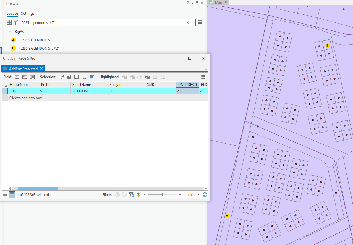

Where as if I use  # in front of the unit designator, I'll get the unit as the secondary hit (B):

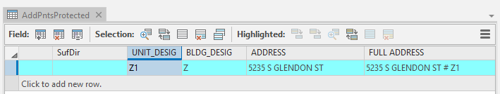

Is this expected behavior?  We do carry a field called 'FullAddress' that carries the unit with # but I'm not referencing that field at all in my parameters (Notice it's # (space) Z1):

You will need to include a unit type (#, Apt, Suite, Bldg) before the actual unit value in order to return a successful subaddress candidate in the Locate pane. If a unit type is not included, the subaddress will not be returned as a candidate. From my experience, these unit types are somewhat interchangeable and if in your reference data the unit type was designated as "Suite", you would still be able to return a candidate with "#", and vise versa.
The issue reported by Bryan in the other post (no subaddress candidate returned) was still reproduced even when a unit type was included with the input address when the reference data was sourced from an enterprise geodatabase. We were unable to reproduce this when sourced from a file geodatabase, but again, as long as a unit type was included with the unit value (e.g. 606 Main St #100).
Hope this helps!

Why though when I include the #Z1, does my address come up as the 'B' choice and not the 'A' choice?  In the case of the traditional composite, with the address points as the first locator at the 'top' of the composite list, that address would have hit at 100% and game over.
