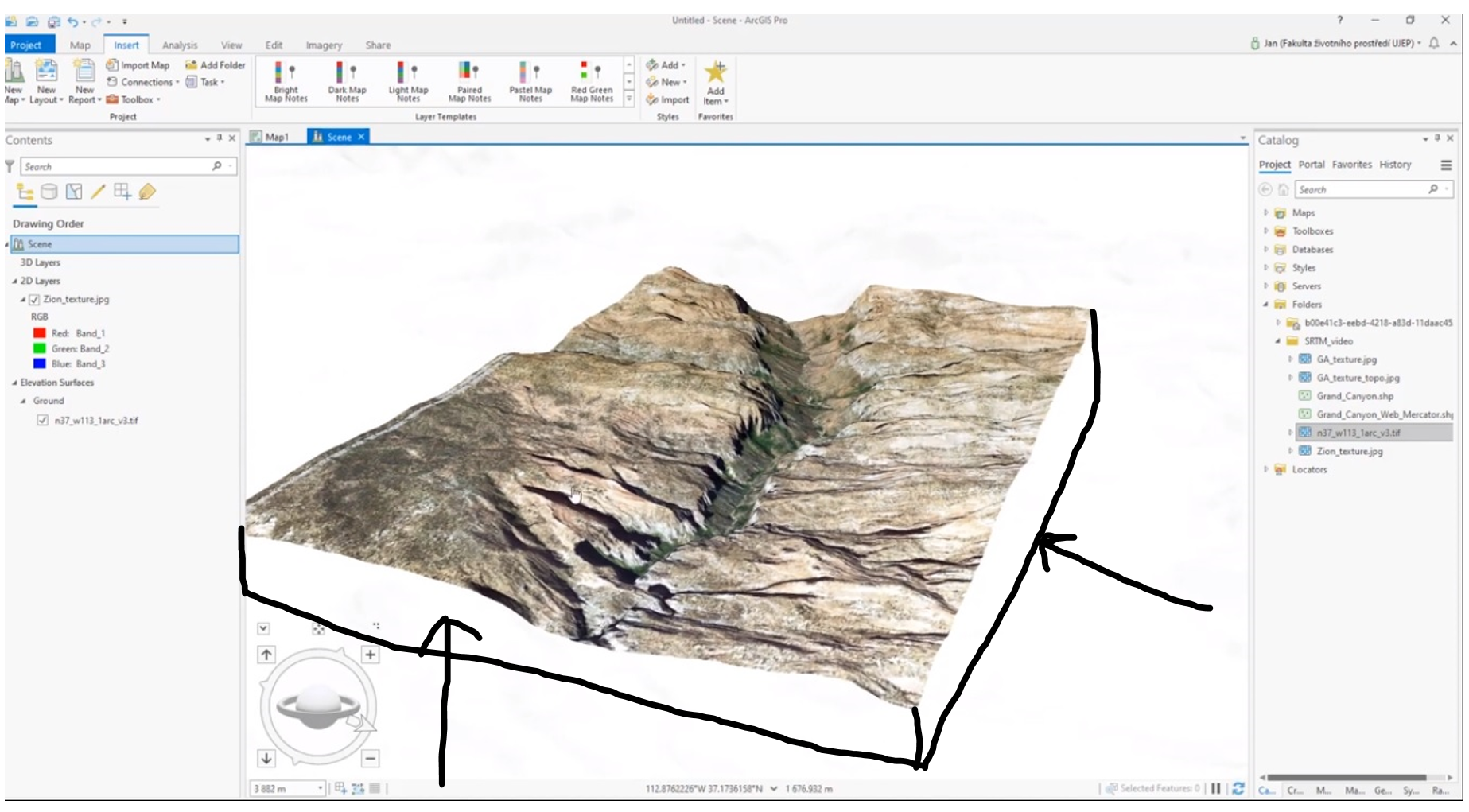

Hi all,
Not sure if this is possible but I want to make my 3D DTM look a little more appealing. Is there a way to add a block/depth to the DTM to make it more visually appealing. I've crudely used a example from the web below, but gives you an idea of what I would like to do. Is this possible?
Many Thanks
Ed_
by MVP Regular Contributor
This video by Mr. Nelson, I am a fan of his work🙂, shows exactly how to do this, enjoy and good luck!

GrahamDriver
Absolutely brilliant, thank you so much Ed! I've still lots of tricks to learn!
