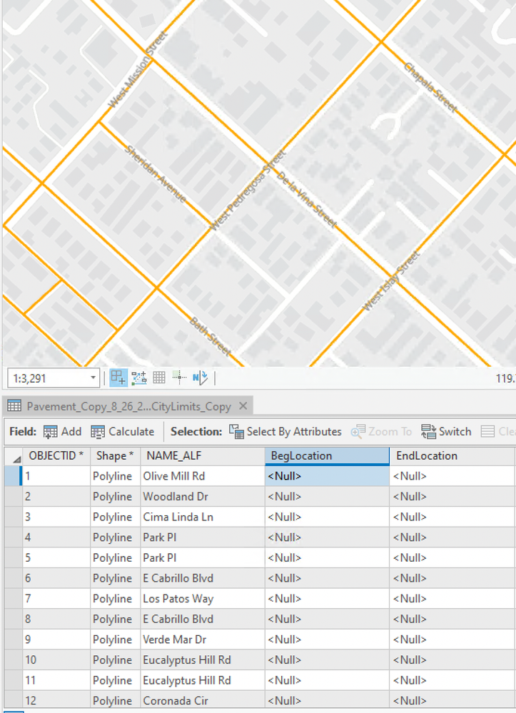

Starting Data
  • Feature Class (Road network of street segments with the following fields: NAME_ALF (Street segment name), BegLocation (Segment Start, intersecting road), EndLocation (Segment End, intersecting Road)

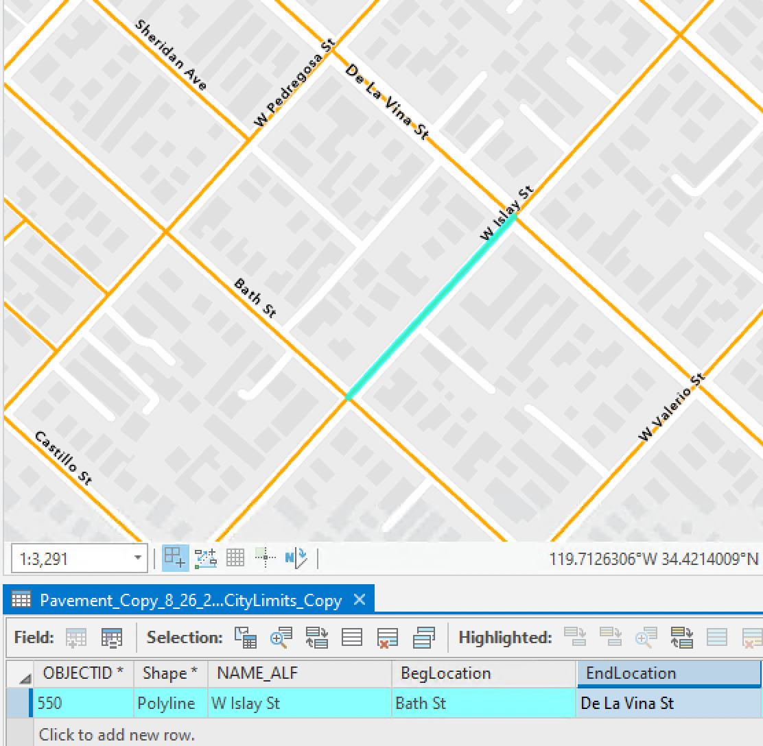

What I would like
 Thanks for any suggestions or pointing me to the best practice for this.

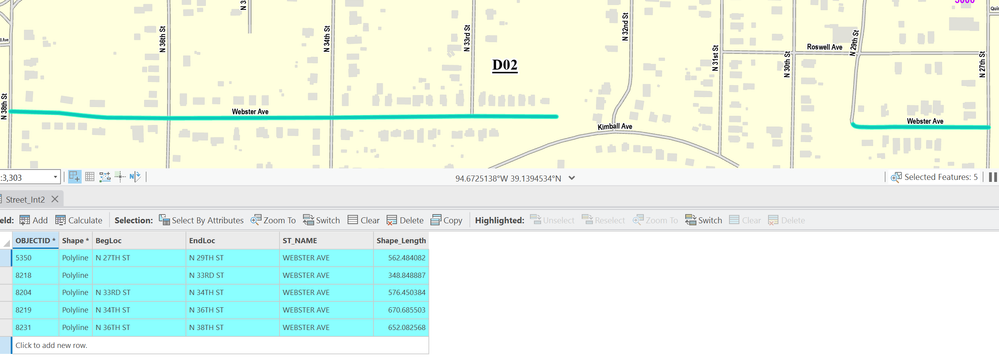

This solution worked perfectly for street segments, but is there a way to do the same thing for street segments that are connected? A shown on the map, some streets with the same name are separated.

Elizabeth_Burniston
Actually, and I should have thought of this earlier, I think my first step is to dissolve the street segments of a continuous street. Then the field calc would give me the results I need. I got it! Thanks for the initial solution!
