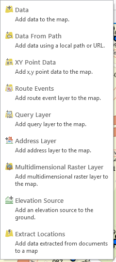

Hi you can add data from path one at a time:
BruceHarold
Esri Frequent Contributor
LukeWebb
Thanks!
