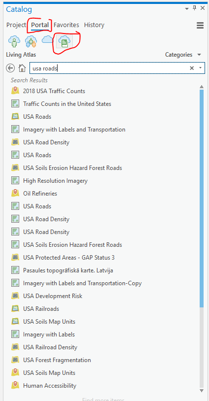

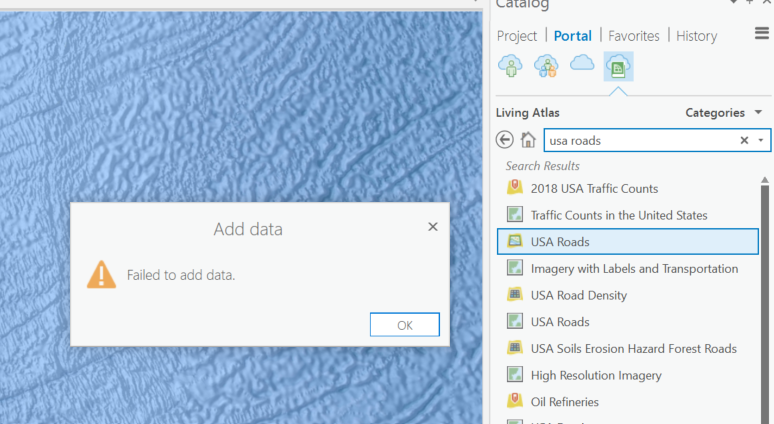

I have been trying to add USA Major Roads to my ArcPro map. I keep getting the below error.
It is a layer package, so I have downloaded it. It was created in my User > Documents > ArcGIS > Packages folder, but when I go to that location, and try to add the .lyr file, I get this exact same error. I got this layer package directly from Esri's Portal.
This layer file adds to ArcMap just fine.

What is the data source for the layer?  Is it sdc?
JessicaEchevarria1
Here is the location in Portal, it is just a layer package https://www.arcgis.com/home/item.html?id=871852b13b53426dabdf875f80c04261
I have never worked with an SDC format, how do you tell if it is or not?
KoryKramer
Esri Community Moderator
Yes, it is an .sdc file type which is not supported in ArcGIS Pro:

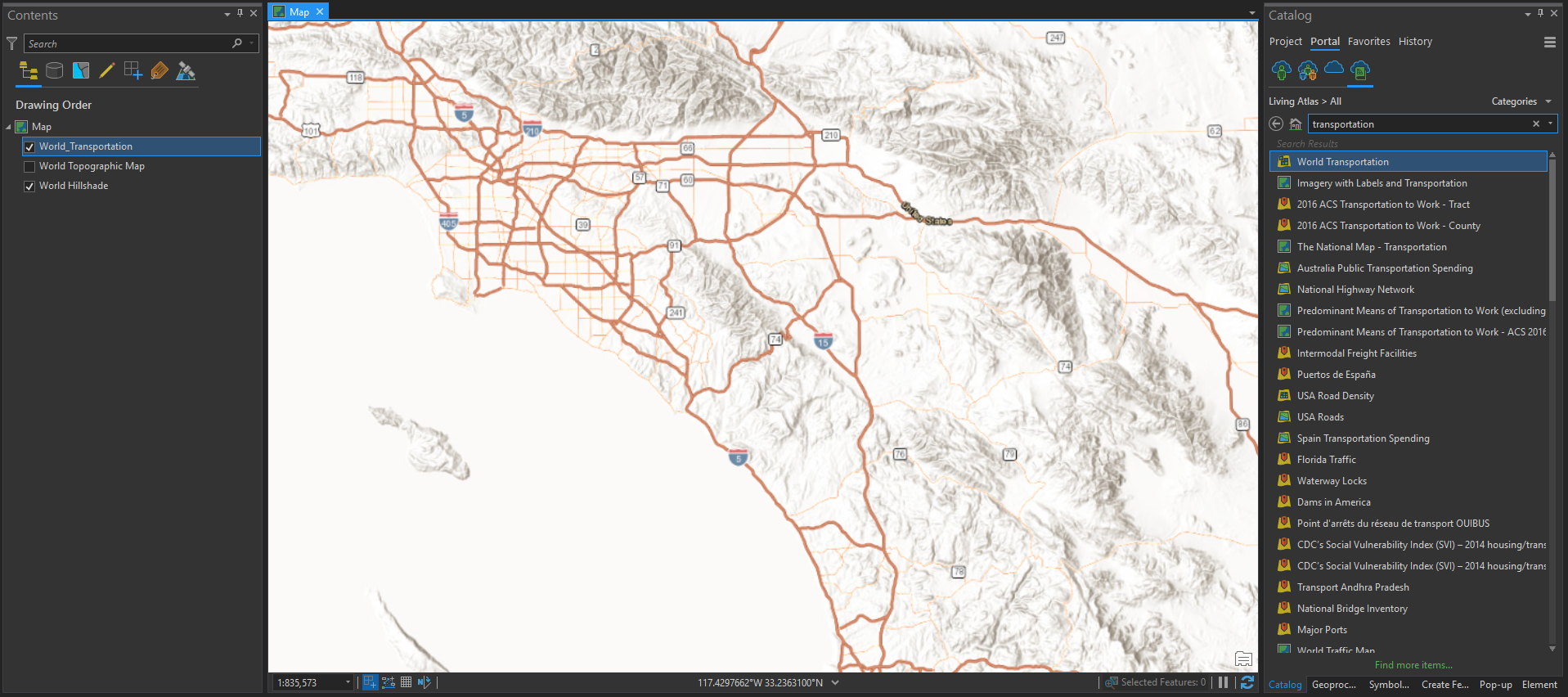

What about the World Transportation layer?
Or other publicly available data? https://hub.arcgis.com/items?tags=roads
JessicaEchevarria1
Yeah, I found a world roads feature class that I was able to bring in. I was just trying to use the Living Atlas to get some practice working with it. All is good with my map now. Thank you for all your help!
