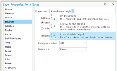

Scott_Harris
@JaimeSáezPrat check the layer properties for the Points. It sounds like you have them 'On the ground' and need them to be 'At an absolute height'
