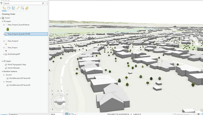

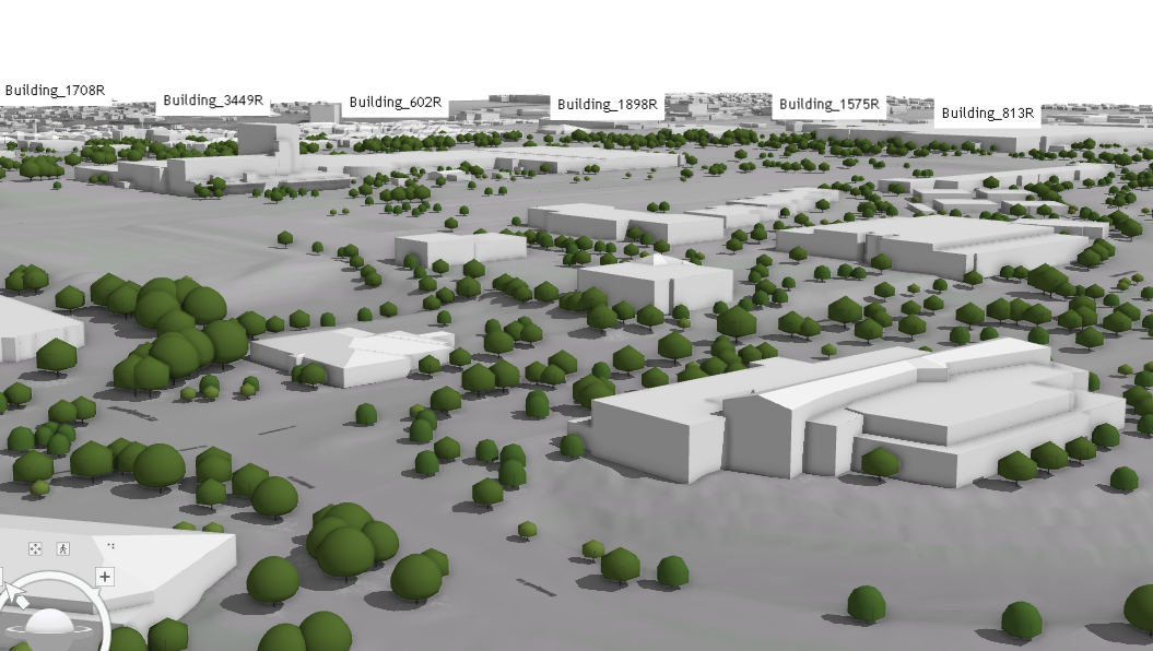

Working with the 3D Basemap solution, I've successfully created buildings and turned them into multipatch buildings, and published them as web layers. Moving on to the publish trees tasks, I'm getting bizarre results when I run the 'create analytical trees' task. Following the task instructions up to that point has gotten me accurate trees, at an accurate height.

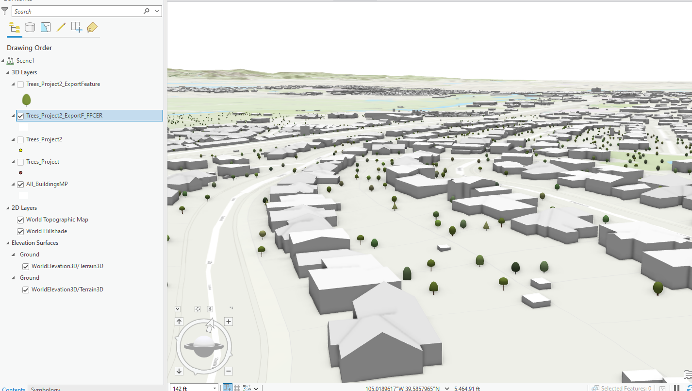

But when I run the 'create analytical trees' task, it outputs trees that are not at a correct height:
They're tiny!
