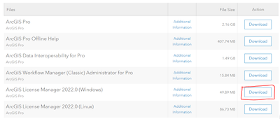

You may download ArcGIS License Manager 2022.0 from My Esri. (My Organizations > Downloads > ArcGIS Pro 3.0 (View Downloads) > ArcGIS License Manager 2022.0 (Windows) > Download.
Then, follow the steps for upgrade from your installed version of ArcGIS LM to the latest version of ArcGIS LM.
License manager installation and startup—License Manager Guide | Documentation (arcgis.com)
