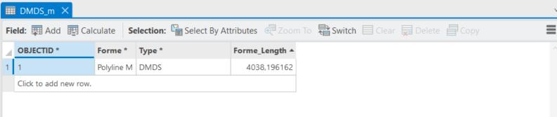

Here is the log associated with this error 🙂

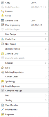

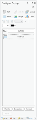

If you right click on the layer that is having the issue (in your case it looks like DMDS_m) you should see "Configure Pop-Ups".
Clicking this will give you the Dialog for configuring the Pop-ups and where you can turn off the offending layers.

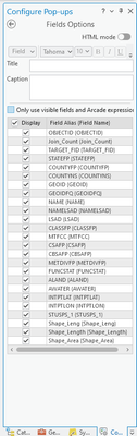

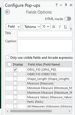

Double clicking the generic "Fields" will open the field options and unchecking the "Only use visible fields and arcade expressions" box will allow you to deselect the appropriate fields.
It seems anything marked with Measure needs to be unchecked to clear this error.

TechnipipeCommercial
Hello @FlightDeck
I just tested this solution by removing all the fields associated with measures, but I get the same result..
