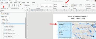

I set the size of the title font size to 20 pts. in all of my layouts (there are 4 different layouts). I'm creating each of the layouts from the same map content. However, when those 4 layouts are exported to PDF (all 8.5 x 11-page sheets), the size of the word "Legend" is not the same in each PDF. I don't understand why. I need to create consistent-looking exhibits each time. What am I missing?

All the same font type. I don't understand your second question. I have an inserted legend. I size the title (the word "Legend") as shown below
AubriOtis
Ah, ok I understand, you are using a legend. I didn't realize that, I thought you were talking about a regular title text eleemnt.
This isn't a bug, text in a legend can shrink to make sure all the text fits. You can control how or when that text shrinks by adjust the fitting strategy of the legend. Learn more about fitting strategies here: https://pro.arcgis.com/en/pro-app/latest/help/layouts/layout-fitting-strategies.htm. Changing the fitting strategy may help here, although which one you want to use will depend on the specifics of your legend.

So this seems to have worked. I used a "adjust frame" fitting strategy. I think it would be nice to see a message something like "Current fitting strategy will alter font sizes selected"
