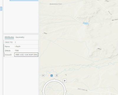

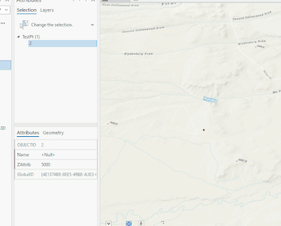

In the meantime, here are two lightly-tested attribute rules to help
// Set geometry to match your Z attribute field
// Field acted on: Shape
// Triggering Field: Z attribute
// Triggers: Update
var geo = Dictionary(Geometry($Feature))
geo["z"] = $feature.ZAttrib
geo = Geometry(geo)
return geo
// Set Z attribute to match geometry
// Field acted on: Z Attribute
// Trigger Field: Shape
// Triggers: Insert, Update
var geo = Dictionary(Geometry($feature))
return geo["z"]
