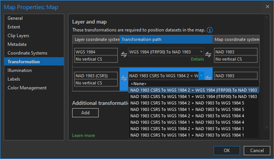

I believe ArcGIS Pro already supports several transformations between NAD 1983 (CSRS) and WGS 1984 geographic coordinate systems. If I set the map to NAD 1983 CSRS UTM Zone 16N (WKID::3160), I get the following possible transformation paths:
In which coordinate system is your Canadian CSRS data? If it is using one of the NAD 1983 (CSRS) realizations (e.g. NAD83 (CSRS) v6, WKID::9644), we do not have any defined because none of the are registered with EPSG nor we can find them on Natural Resources Canada's website.

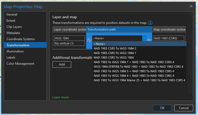

I have used this  2 part transformation with some success, I think Arcpro uses it by default now:
I doubt it is as accurate as the custom Ontario CSRS transformation from the province, but it seems to project the data properly.

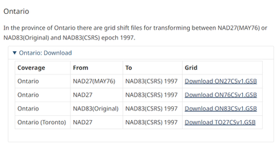

For the Ontario province, we do have definitions for transformations to NAD83 (CSRS) v3, WKID::8240, provided by NRCAN (I know this is not what your are looking for but it might help.):
Due to license restrictions at the time we added these definitions into ArcGIS, we do not distribute the necessary NTv2 files with the ArcGIS Coordinate Systems Data software component. If you wish to try them out, you can download them from the NRCAN website or from here and add them to a specific CoordinateSystemsData\pedata subfolder on your machine. Files are sorted into folders by transformation method name, such as NTv2 or vertical\geoid. For these four transformations, you should add the NTv2 files to <System Drive>\Program Files (x86)\ArcGIS\CoordinateSystemsData\pedata\ntv2 folder. Please contact your local distributor if you have any troubles or need more detailed instructions.
