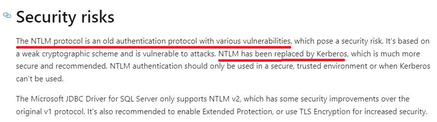

Status changed to: Closed
NTLM has been replaced by Kerberos.  There are currently no plans to support NTLM in future releases of ArcGIS Pro.
