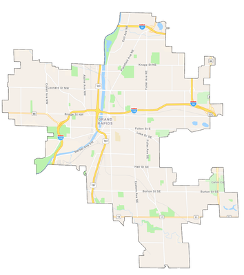

@MarkBockenhauerthis worked for one of my target counties. But it hasn't worked since. Now when I generate an mmpk no .vtpk gets generated in the 'commondata' folder for some reason... any ideas as to why?
the AOI poly isn't particularly complex (geometry wise)... I'm confused as to why a .vtpk was generated for the first county but not the others.

The Create Mobile Map Package tool can be used to clip a vector tile package that you have on disk.  So, you do have a vector tile package on your local file system that you are running through the tool?  correct?
cweirpatrickco
@MarkBockenhauer  awesome, I added a .vtpk from my local to the map frame and then exported to .mmpk and the clipped .vtpk was in the output... Thanks!
