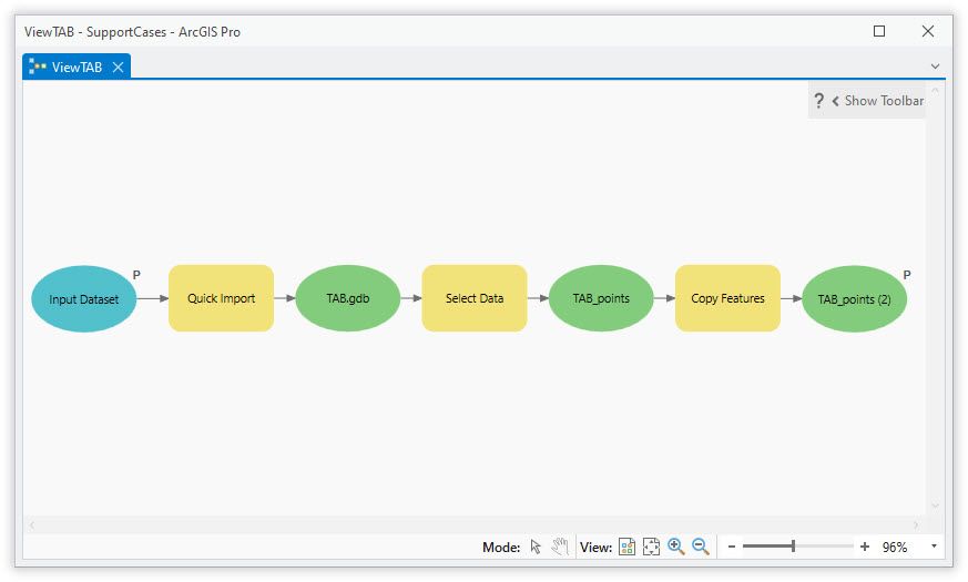

The nature of Pro makes it hard for us to replicate the interoperability connection experience you are referring to.  What you can do is create a toolbox with a model that does a Quick Import then copies the data into memory and into your map, like this:

@BruceHaroldGreat idea to keep it in memory. I am not sure if I then have to rerun the step every time I open the map again? I am curious about what made it easier for you to implement in ArcMap?
BruceHarold
The multithreaded nature of Pro and that Data Interoperability runs in a separate process made it hard to make connections work.  Memory workspace persistence between sessions is coming but I'm not sure of the time frame.
