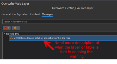

When publishing and missing a related table or layer, there are no layers or tables identified as missing.  This is helpful to understand when there are a ton of relationships added to each layer within a feature service before publishing.

Thanks for submitting this idea @SavageTrimble. This was added in the latest release of ArcGIS Pro 3.3.
