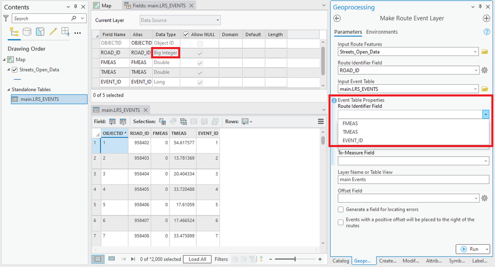

I have a linear referencing standalone table. The table has a user-defined ID field that is a big integer datatype.
I want to use that field in geoprocessing tools like Make Route Event Layer. But the big int field isn't shown as an option in the Route Identifier Field parameter picklist.
Could all geoprocessing tools, including Make Route Event Layer, be enhanced to allow mobile geodatabase big integer fields?
2 Comments
Bud
The same Make Route Event Layer issue applies to file geodatabases too.
As well as with the Create Routes geoprocessing tool using an Oracle 18c database FC (non-geodatabase).
