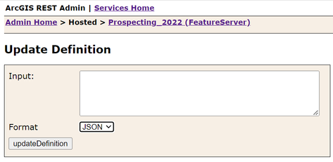

However, I am having the following error when I am trying to update the definition:
 "error": {
  "code": 500,
  "message": "Field 'preferredTimeReference' cannot be updated.",
  "details": []
I also noticed that the textbox is already empty when access the Update Definition mode…
What could that possibly be?
TanuHoque
hi @AlekseiPlatushin
What version of ArcGIS Enterprise you have?
