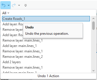

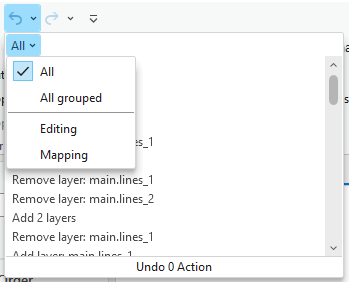

Splitting Map actions and Edit actions as requested in the idea is already possible:
That said, even I am showing All, I still see the ability to undo just the 'Create' without removing the layer:
If you're seeing different behavior, that may need to be investigated. You could ask a Question to work through it with other Community Members, or call tech support.
Bud

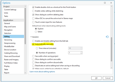

For my notes, I only see the "All" dropdown when automatic edit saving is turned off.
And as Kory mentioned, I can undo the Create:
However, if I re-enable automatic edit saving, then I no longer have the option to undo the edit.
In hindsight, in my original post/scenario, I realize the edit wasn't actually undone. Only the layer was removed.
The root cause seems to be: When automatic edit saving is enabled, we can't undo edits.
