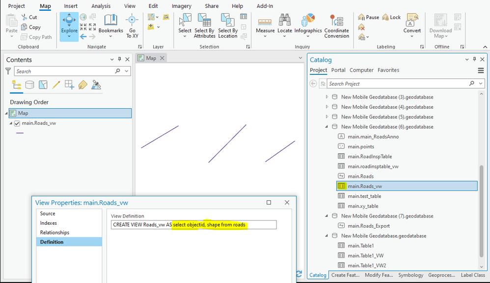

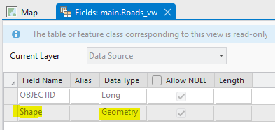

I've created a spatial view in a mobile geodatabase; the view has a shape column.
The Catalog icon for that dataset indicates that the object is non-spatial; it uses the same icon that is used for a standalone table.
I find that misleading. I think it would be more intuitive if the icon indicated that the dataset is spatial -- different from a standalone table or a non-spatial view.
Could the icon in Catalog be changed for spatial views?

Thanks @Bud,
This looks like a bug.  I've brought it to the attention of the team.  Thanks as always for your keen eyes!
Bud
Esri Canada Case 03294811 - Catalog icon for mobile geodatabase spatial view
BUG-000157223 - The View Icon shows as Standalone table instead as Feature Class in Mobile Geodatabase
