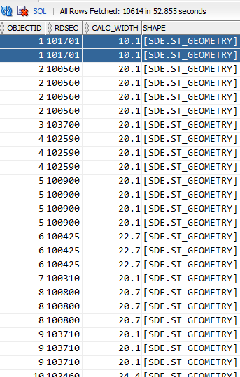

But with a spatial SQL operation like this:
--Oracle 18c, SDE.ST_GEOEMTRY
SELECT r.* FROM road_row_st_geom r, --cross join strln_st_geom s WHERE sde.st_intersects (r.shape, s.shape) = 1 ORDER BY r.objectid
...it produces rows with duplicate objectids, whenever the polygons in the first FC intersect multiple lines in the second FC.
That's a typical difference between ArcGIS Pro vs database queries. ArcGIS usually performs only does 1-to-1 or 1-to-first queries. Whereas databases queries will propagate duplicate rows via the join.
10,614 rows selected.
I often forget about that quirk.
But I suppose, now that I think about it, if Esri were to implement the Spatial Definition Query idea, they'd do what they always do: only perform a 1:1 selection. So the quirk I mentioned above wouldn't be an issue for the user.

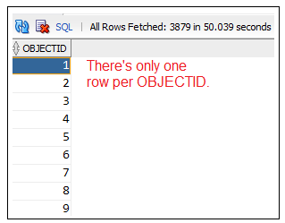

If I were to mock up the 1:1 logic in an Oracle query, it might look like this:
  SELECT objectid
    FROM (SELECT r.objectid,
                 row_number() over(partition by r.objectid order by r.objectid desc) rn
                 strln_st_geom s
   WHERE rn = 1
ORDER BY objectid
3,879 rows selected.
But I doubt ArcGIS Pro uses that syntax. It might use some sort of generic ANSI SQL subquery or something like that?
It's interesting that Select By Location selected 3,800 rows. But my Oracle SDE.ST_GEOMETRY query selected more rows: 3,879. I wonder why there's a difference?
