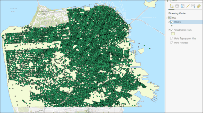

TanuHoque
hi @Anonymous User,
As you see, after @KoryKramer merged your post here, we don't have any out of the box capability at this point.
For now, I can give you a workaround and it will ONLY work if:
  1. if both of your layers are coming from the same enterprise database (doesn't need to geodatabase).
    • won't work for file geodatabase
  2. both of them are in the same projection (on the fly projection won't work)
Steps to filter out features from layerA using feature(s) from layerB
  • First get the source FeatureClass name for layerA
    • do the same for layerB
      • let's assume they are named DS-A and DS-B respectively
  • Open layerA's Proeprty page
  • Switch to Definition Query page
  • Create a new one
  • Switch to SQL mode by clicking the SQL toggle button from the upper right corner
  • Paste one of the following two sql clauses.
    • even though the send one looks pretty straight forward, I found it didn't perform well in my quick test.
      • I'm not a SQL guru, therefore I can't explain why 😞
  • Click OK
The syntax provided below are for SQL Server. The STIntersects() function syntax will be different on PostgreSQL or Oracle or other databases.
SQL#1
objectid in (select DS-A.objectid from DS-A
inner join
(select shape from DS-B
where aField = 'aString_Value' ) a
on a.shape.STIntersects(DS-A.shape) = 1)
SQL#2
exists (select 1 from DS-B a where aField = 'aString_Value' and a.shape.STIntersects(DS-A.shape) = 1)
Here is animation showing how I did that on my side:
