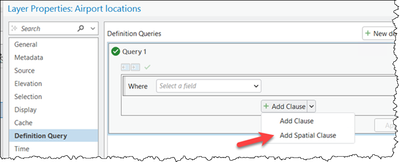

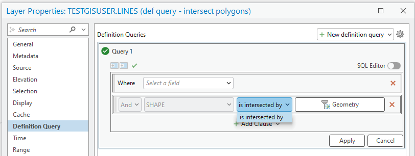

Implemented in ArcGIS Pro 3.5. Click 'Add Spatial Clause' to add a new spatial clause to your definition query.
please note:
  • you can only have one spatial clause in a definition query
  • the search geometry you pick are used by value. As a result if the source geometry gets modified later in the layer, that won't have any affects to the spatial clause.
  • 'is intersected by' is the only spatial relationship operator supported currently
  • currently only AND operator is supported while getting combined with attribute clause(s)
