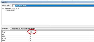

In the Identify Window of ArcMap (that shows the results of the Identify Tool) you can click on the column headings and the values will be sorted (see image below). However, in ArcGIS Pro when using the Explore Option to query the map, the pop up that shows the results doesn't give the option to sort the columns.
Can you add the functionality to sort the pop-up window columns in ArcGIS Pro?

We can define the sorting order within the configuration of the Fields element.  This saves us from having to manually apply sorting within the pop-up itself and we get the added bonus of it being maintained at all times as part of that elements configuration.  To do this, right-click on the Field Alias {Field Name} column header when editing a Fields element and choose the desired sort order. This is available in Pro 2.6 +. Thanks!
