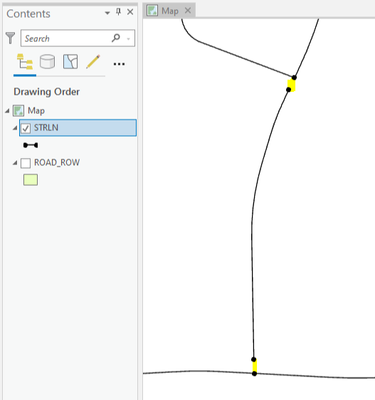

Here's my current use case, although there are others:
For each road line, I want to count the number of right-of-way polygons that the line intersects (using the Spatial Join geoprocessing tool). The relationship should always be 1 line to 1 polygon. So if the spatial join count isn't 1, then that area needs to be investigated.
The problem is, the roads often slightly overlap other polygons at road intersections, since the polygons aren't snapped to the road endpoints. And automatic snapping isn't an option in scenarios like these: screenshot. So the spatial join will count polygons that I don't care about.
So I figure, if I shorten the lines at each end in a copy FC, either by a measure or by a percentage, then that will avoid counting polygons that just barely overlap the roads.
What do you think?

Perhaps you can use Feature Vertices To Points with Midpoint option to obtain midpoint of each line. Then use Spatial Join to join polygons with the midpoints using "Contains" option. For your scenarios:
  1. 1 polygon intersects many lines: Look for polygons with Joint_Count >1 (your red box #1)
  2. 1 line intersects many polygons:  Look for polygons with Joint_Count = 0, (two of the three polygons in your red box #2 would not contain the midpoints)
  3. Lines that don't intersect any polygons: this needs Spatial Join of the midpoints of lines with polygons, then look for Joint_Count = 0.  Could there be any line with midpoint is not inside any polygon but the line still intersects a polygon?
  4. Polygons that don't intersect any lines:  This may need Spatial Join of the polygons with line using the "Crossed by the outline of" option (I didn't test this, so not 100% sure).
With these processes, you may not need to shorten your lines?
