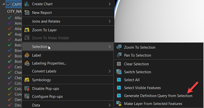

This capability is available as the new Generate Definition Query From Selection geoprocessing tool, and (as some suggested here) that is accessible directly from a layer's context menu off the Contents pane.

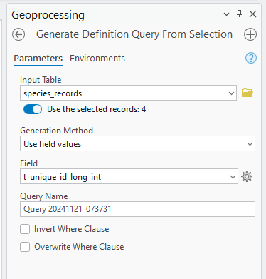

@TanuHoque The docs describe a "Where Clause (Optional)" parameter.
https://pro.arcgis.com/en/pro-app/latest/tool-reference/data-management/generate-definition-query-fr...
I don't see that parameter in the GP tool.
Under what circumstances would we see that parameter in the tool?
