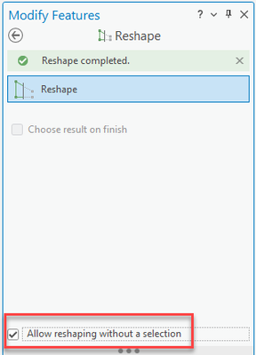

@RickHavel
Depending on the data and scenario, this option might work for you:
John_Jones
Another option that may work for you is that if you hold down the SHIFT key while reshape is active it will momentarily switch to selection mode to allow you to select a different feature to reshape.
As for why reshape stays in reshape mode after a successful reshape (while continue does not) it is because it is a reasonable workflow to reshape the same feature multiple times at different areas along the feature (while continuing the same feature twice is less obviously useful as you could have just continued more the first time.).
You could also assign a keyboard shortcut to clear the selection, which may be helpful as after the selection is cleared reshape will switch back into selection mode.
