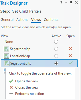

PhilLarkin1
This doesn't quite target your use case, but I found it helpful when trying to set the active map in a project. If a script is run via a Task the Views setting can be applied to Activate a map and close others. This was super helpful for me. Ideally this could also be achieved in ArcPy as well.
