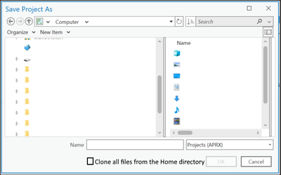

It is possible to save a Project Package (ppkx), but having an option in the "Save Project As" dialog would be nice:
Instead of only saving the .aprx file under a new name, also clone the files from the current home directory to the new directory, where the APRX is saved to.
Why is it useful?: If you have different versions of an APRX file, all referencing the same GDB, accidental changes to the data can happen. If you try out different Project configurations for example.
