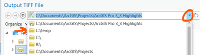

KoryKramer
@pdtanimot depending on how you have your browse dialog options set: https://pro.arcgis.com/en/pro-app/latest/help/projects/catalog-browsing-options.htm#ESRI_SECTION1_19...
... in the output folder you should be able to use the dropdown arrow. That will always display the Home folder first and then the most recent locations after that. In this example, I wrote a file to C:\temp. Instead of having to drill through a bunch of folders to get there again for another gp output, I can get to it quickly like this:
Does that help?

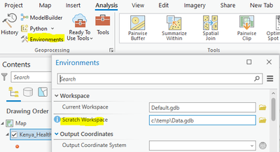

I want to bring up that the default output location for geoprocessing tools is by default set to the project's default geodatabase, but this can be configured to any location by setting the Geoprocessing Environments workspaces. A few folks that described what they want in this thread could benefit from setting their scratch workspace to their preferred location, which will make the default output paths generated in that location rather than the project geodatabase.
https://pro.arcgis.com/en/pro-app/latest/tool-reference/environment-settings/scratch-workspace.htm
pdtanimot
Hello.
DrewFlater, I did not find that helpful, as the output dialog still defaulted to the project (.gdb) folder, with the 'folders' option.
However, KoryKramer, I found that very helpful, and I hope and think your suggestion will take care of always needing to drill down through the hierarchy. Thanks so much.
