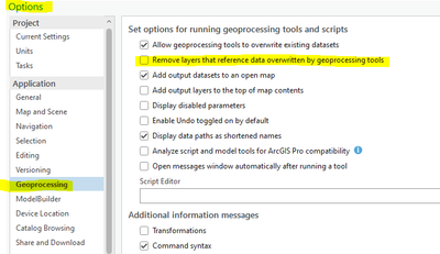

Status changed to: Implemented
This option is already available since the Pro 1.x series. Many users prefer the behavior you describe, and others want the opposite behavior, so we needed to develop an option to suit either case. This and the other Geoprocessing Options are set at the application level so apply to all your projects that you work with on that machine. Most of these options you can set once to your preference then forget about them 🙂
https://pro.arcgis.com/en/pro-app/latest/help/analysis/geoprocessing/basics/geoprocessing-options.ht...

That is perfect this already exists - thanks so much!
