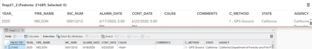

@Debert when I pull a hosted feature service from ArcGIS Online into Pro, field order is the same (Online on top, Pro on bottom in the image below).
You can save a layer file that hides and re-orders fields. When added to a map, it's still referencing the same hosted feature service but honors the layer definition in the lyrx.

@KoryKramer I see the image on the top has field ordering of [Year, Fire Name], while the image on the bottom has field ordering of [Fire Name, Year]. And, while having only 2 fields doesn't cause as much of an issue, that field ordering is not the same.
Add 10-15 custom attribute fields, plus 28 GNSS receiver metadata fields, and you have a jumbled mess of attribute fields. People get use to seeing certain fields in certain orders, which also helps with editing.
